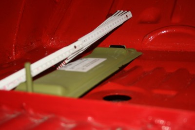

I bought replica fuel mounting platte T1.
I think, it is a same for T1 and T2a. My Doka is T2b, and unfortunatelly T2b have a different floor - T2b have a higher step. T1 und T2a is without step.
See attached picture.
Do You have anybody picture of right T2b fuel tank mounting platte?
